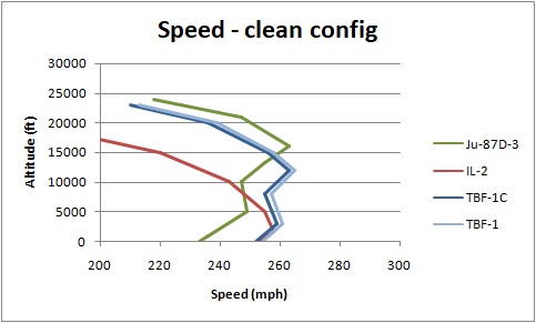

---== THE TBF AVENGER SERIES FULL REHAUL ==---
The Grumman Avenger first made combat entry at the Battle of Midway 1942, and soon became one of the best American single engine carrier bombers of the Pacific War. As Grumman switched production to the F6F Hellcat, General Motors took over the production renaming the plane to "TBM". The TBF had a crew of three with both a .50 cal top turret and a .30 cal ventral gunner. The ventral gunner was also the radioman/bombardier and had a full arsenal of the most advanced radio equipment used in a single engine plane of WW2. The Avenger was rugged, large and handled like a truck. With 4x 500 lb bombs the TBF-1C weighed in at 16425 lb. It's powerful 1700 hp Wright R-2600-8 engine and huge 490.02 square feet wing area meant that it had almost the hp/weight ratio and wingloading of a F4F-4 Wildcat though. This actually allows a clean Avenger to turn with some of the contemporary fighters except the nimbler ones. It's a handy defensive strategy, especially against the heavier late war fighters, although the Avenger is clearly inferior to fighters regarding top speed, climb rate and roll rate so should avoid dogfights if possible. The TBF's have a diverse set of loadouts and can also carry a large drop tank in the bomb bay for long range scouting missions.

Powered by the 1700 hp Wright R-2600-8 engine the TBF-1 is a very good single engine bomber for it's era and can be used successfully for both torpedoing ships, deploy sea mines, dive bombing, or level bombing from the bombardier view. It is armed with a single forward firing .30 cal machine gun that can be used for strafing if needed.
--= TBF-1C =--
The -1C made entry in 1943 and is very similar to the -1, but has an improved forward armament of two .50 cal machine guns. This makes it better for strafing purposes and also allows it a fair bite against enemy planes who underestimate the turn rate of an unladen Avenger (It also has a higher airspeed velocity than an unladen swallow). The TBF-1C can also use two wing drop tanks for long range bombing missions.

The TBM-3 was built by General motors and made combat entry at the start of 1945. It has a 200 hp stronger Wright R-2600-20 engine as well as the option to carry rockets and a better bomb load. An important difference is also the new engine's better high altitude performance, allowing the TBM-3 a 32 000 ft ceiling as well as a better top speed up high. This enables the TBM-3 to ingress above 25 000 ft, where American escort fighters have a distinct speed advantage over the Japanese fighters.
