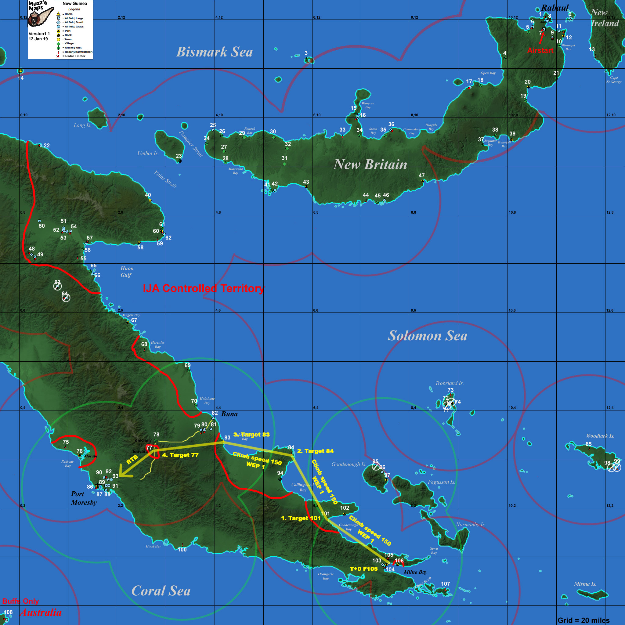

I'm also wondering if given what the 4th is tasked with, if we could launch from 105 and run right up the coast and hit our targets, then rtb F91?
 Post subject: Re: Frame 4 Orders
PostPosted: Sat Feb 09, 2019 4:39 pm

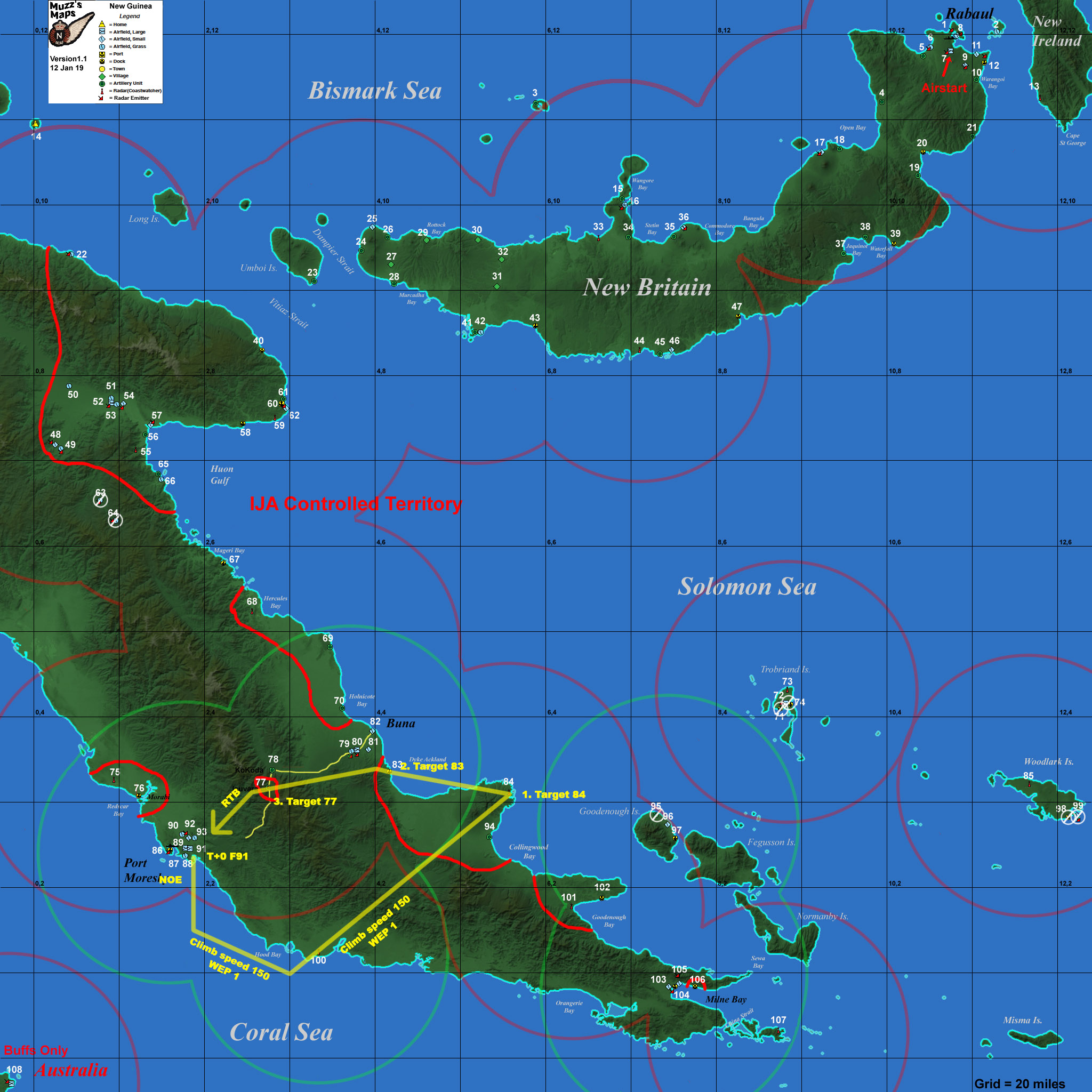

2 possible routes for 4th FG 1st sortie.
comments?

RGR thanks... I could have a few split off and hit it, then regroup..
