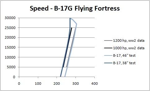

--= Boeing B-17 Flying Fortress series =-
The B-17F and B-17G have been fully remodeled. They should now be close to real life performance and can use a larger payload than before. The B-17F can now carry 9600 lb of bombs, the B-17G 12800 lb of bombs as per their historical max loads. Previously they were both limited to only 6400 lb of bombs.

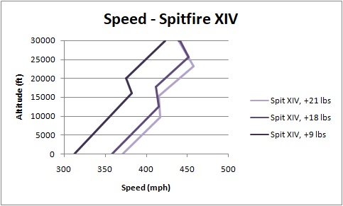

The Spitfire XIVe now has 3 boost stages, with a +18 lbs manifold pressure boost stage added for Bst2.

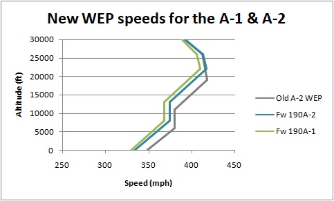

--= Fw 190A-1 and Fw 190A-2 =--
The A-1 and A-2 have had their engine WEP setup rebuilt. The WEP stages of these planes were previously estimated to generous in BHP and have now been set according to better speed data found.

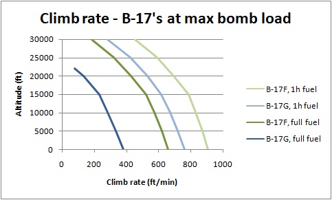

---== THE BOEING B-17 FLYING FORTRESS SERIES FULL REHAUL ==---
The B-17 Flying Fortress is an iconic bomber and has been featured in several movies. It was a large four engine bomber armed with an arsenal of .50 cal machine guns facing in every direction. The Flying Fortresses were though adversaries for the Axis fighters and forced the Luftwaffe to arm their interceptors with heavier cannons. Still, without fighter cover, even the B-17's took heavy losses when deep into Germany, but once the Mustangs could provide escort all the way to target and back, the dwindling numbers of Luftwaffe fighters could do little to prevent the Allied bombardments of Axis facilities. Both the B-17F and the B-17G are powered by four Wright R-1820-97 Cyclone engines, each able to produce 1240 hp at 15000 ft. The engines have a very good high alt performance, and a clean B-17 might even be able to outrun several interceptors, those with poor high alt performance, at the Fortress' maximum altitude. A clean B-17 at low fuel can get above 37000 ft. The Flying Fortresses are now able to use external 1600 lb or 2000 lb bombs under the wings, and has a wide array of loadouts. The B-17F can carry up to a limit of 9600 lb of bombs, while the B-17G has an impressive max payload of 12800 lb. As such they now carry their historical max payloads, while previously both B-17's in Warbirds have been limited to only 6400 lb. The B-17 is quite easy to fly and the stall is mild. Do note though that the B-17's are now realistically modeled, and players can no longer fly at zero throttle for an extended time without stalling out.
