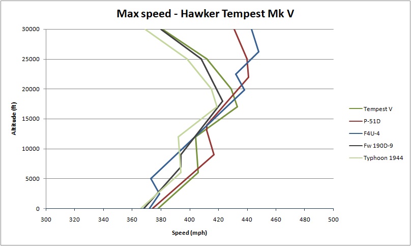

--= Hawker Tempest Mk V new flightmodel =--
We are happy to announce the famous Hawker Tempest V has been fully modeled and will be included in Warbirds. It will currently use the Hawker Typhoon 3d model which looks quite similar, hopefully it can get it's on 3d model in the future. The Tempest V will be available at two rear LAF fields per side on each Legacy Arena map, just like the Spitfire XIVe. It enters play in RPS5. See below for more details.

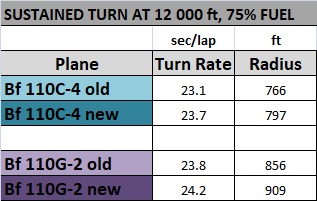

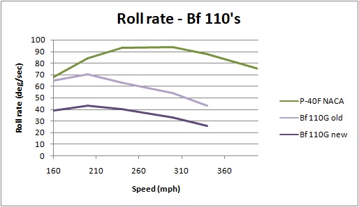

Roll rate significantly decreased to around 60% of current roll rate for both the Bf 110C-4 and Bf 110G-2. Nose heaviness also increased on the Bf 110G-2. Effects from leading edge slats reduced by ca 20%. This increases the stall speed by 2-3 mph and worsens the turn performance slightly. This decreases the overall agility of the Bf 110C-4 and Bf 110G-2.

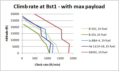

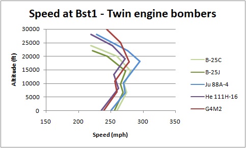

---== THE NORTH AMERICAN B-25 MITCHELL SERIES FULL REHAUL ==---
The B-25 Mitchell was a true workhorse for the Allied airforces during WW2, and nearly 10 000 were built, serving in every theater. The B-25 was nicknamed "Mitchell" in honor of Major General William Mitchell, who was a pioneer of American military aviation. The B-25 was a twin engine bomber equipped with 1700 hp strong Wright R-2600-13 radial engines. The Jumo 111J engines of the German Ju 88 could only produce 1465 hp as a comparison. The Mitchell was quite forgiving and easy to fly, giving pilots a good sense of confidence from the get go. It had a quite decent climb rate and could reach a top speed of 270-281 mph at 14600 ft, depending on version. The defensive armament consisted of .50 cal machineguns. Earlier versions lacked a tail turret, which made it vulnerable to low 6 o'clock attacks. This was remedied with later versions of the Mitchell.

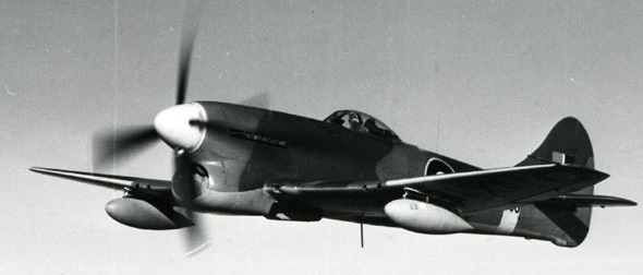

---== THE HAWKER TEMPEST MK V NEW FLIGHTMODEL ==---
The British Hawker Tempest V was evolved from the Hawker Typhoon and was seen as an improvement from the previous fighter. Deliveries to units started in April 1944. The Tempest used the same engine as the Typhoon, the Napier Sabre II, which was capable of 2220 hp and was one of the worlds strongest inline engines ever built. The Tempest also had a completely new wing design. The new wings were significantly thinner than the wings of the Typhoon, and were designed using the Mustang's laminar flow wings as a guidance. With laminar flow wings, the Tempest could reach speeds 12-14 mph faster than the Typhoon, at a sacrifice of it's slow speed turning performance. The Tempest's high speed made it popular for hunting down V-1 rockets, and with 108 gal droptanks it could keep patrol for 4.5 hours. The Tempest was an exceptionally fast fighter at low altitudes, adept at boom n zoom tactics. It was also used well as a ground attack platform, able to carry 2x 1000 lb bombs.
